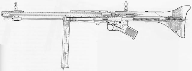

  4. von Poop
    6,114
    1,705
    There's a misconception here; the FG42 wasn't really envisioned solely as a light support weapon. It was requested as a far wider concept automatic rifle, a jack of all trades.
    Cribbed/Paraphrased from Handrich's Excellent 'Sturmgewehr' book:
    The initial request from Otto Schulze (later to head the project) was for a gun:
    *Total length not more than 100cm
    *Total weight no greater than the K98k
    *Capable of single and burst fire
    *Usable as a telescopic sight rifle
    *Rifle grenade capability
    *usable in close combat as a 'blow & thrust' weapon.
    The Official specification as laid down in June 1941:
    1 - No longer than 100cm.
    2 - No heavier than the K98K.
    3 - Same calibre as standard service rifle.
    4 - Detachable magazines, one 10 shot & one 30 shot.
    5 - Selective fire using the simplest possible action firing from a closed bolt in semi-auto and open bolt in full-auto.
    6 - Free from stoppages.
    7 - 1.5X Telescopic sight to be provided.
    8 - Equipped with grenade launcher.
    9 - Equipped with bayonet, preferably a folding type.
    10 - Capable of being used as a club without damage.
    11 - No removable barrel.
    12 - Barrel life of at least 2000 rounds, no matter what mode it's fired in.
    13 - Collapsible grip so as to avoid entanglement when jumping.
    14 - To be provided with a folding bipod.
    15 - The butt to absorb recoil.
    16 - Stable when firing.
    17 - Dirt-proof.
    18 - Insensitive to shocks and drops.
    Most firms were uninterested in developing a weapon not officially sanctioned by the WAa, and so began a tortuous project that seems more to do with Goering's personal gratification than any genuinely sensible use of resources. Without the fat pigeon's personal weight being thrown behind the gun it seems likely it would have been a sensibly still-born project that would not have impinged on and interfered with the considerably more sensible MkB42/MP43/44 (etc.) project as much as it did.

    The comparison with the FG-42 as a German BAR is an apt one. It was an extraordinary weapon in many ways but less than 10,000 were ever made. Goerring wanted only the best for his people and you can be sure he had something to do with the weapon's being approved by the Waffenamt in the first place.
    Perhaps the most extraordinary feature, never duplicated in any gun before or since, was its changeable firing mode. This weapon was designed to fire from a closed bolt while in semi-auto, and from open-bolt mode when set to full auto!
    To explain the difference, which may be unclear to someone who's never been around military weapons, every semi auto rifle you may own fires from a closed bolt. That is, the bolt goes forward, chambers a round, it waits for you pull the trigger, the gun goes bang. The bolt is then pushed back by gas or recoil force and returns to chamber a round while locking forward into the barrel again, while awaiting the next pull of the trigger.
    Open-bolt operation is commonly used in almost all machine guns up to modern times, and was used by almost every submachine gun of WW2. That is, the user cocks the bolt by pulling it to the rear, where it stays. When the user wishes to fire, the bolt now goes forward, strips a round, and fires until the trigger is released (or the gun is out of ammo). When the person operating the gun is done firing it for the moment, the bolt stays to the rear, instead of going all the forward like in your closed bolt weapon.
    The reason for open-bolt designs, which are always less acurate on a single-shot basis than closed bolt, is due to cooling. If a machine gun were closed bolt, there is a chance of chambering a round into a hot chamber and leaving it there, causing the round to cook off and firing when the gunner does not want it to! Thus almost all light, medium and heavy machine guns used to this day, by everyone, everywhere, operate on the open-bolt principle.
    Anyway, the FG-42 was a very interesting and notable firearm of the second world war, but apparently the Germans didn't think very highly of it, due to the low production figures and failure of any other branch of the Wehrmacht to even try to adopt it.
