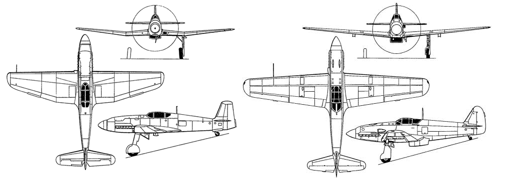

    It's amazing how much that plane resembles the Ki-61 Tony.
    One reason I've read for the official "thumbs down" on the He-100 was Ernst Heinkel's cantankerousness and his perceived "political unreliabilty." His firm was already the holder of too many contracts from Goering's point of view.

    Yes isn't it amazing how much the "Hein" resembles the "Heinkle"...And how much the Mig-3 resembles it also...
