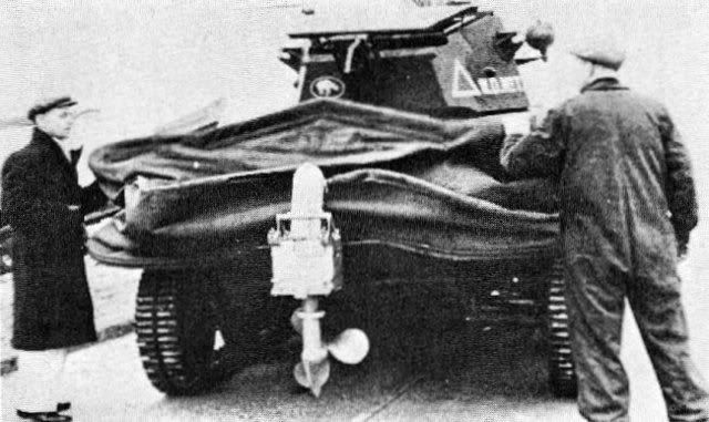

    Some nice pictures of Bovington's DD, which uniquely (?) still has it's flotation screen here:
    D Day Tanks and countdown to 60th anniversary of D-Day from the Tank Museum Bovington

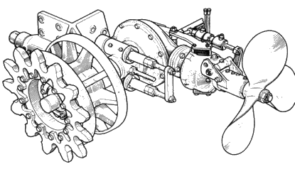

    And a very clear & concise explanation of Straussler's DD system:
    Tank Museum Bovington-straussler DD
    Including this excellent illustration of the drive, showing how an extra sprocket is fixed to the idler so it can be turned by the track and transmit power to the props:

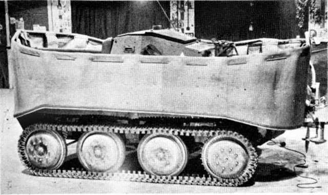

    And some pictures of the first DD based on the Tetrarch (taken from 'tanks') along with more on it's development from the Tank museum: Bovington DD
    Straussler was indeed, a very clever man.
    Cheers,
    Adam.
